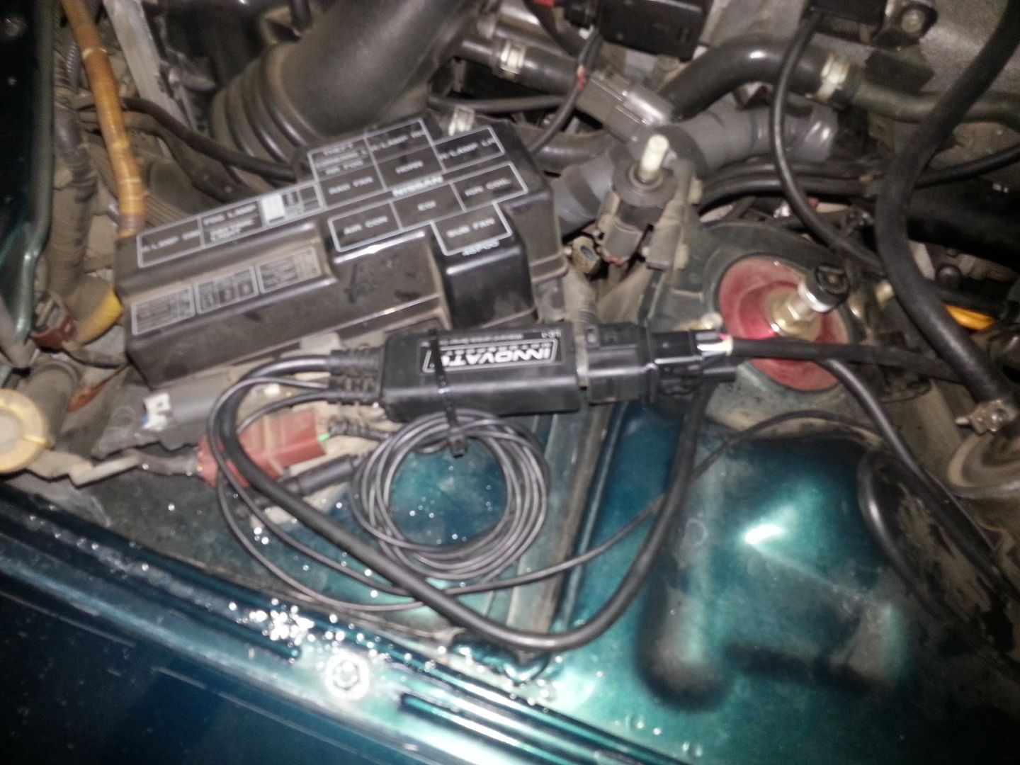

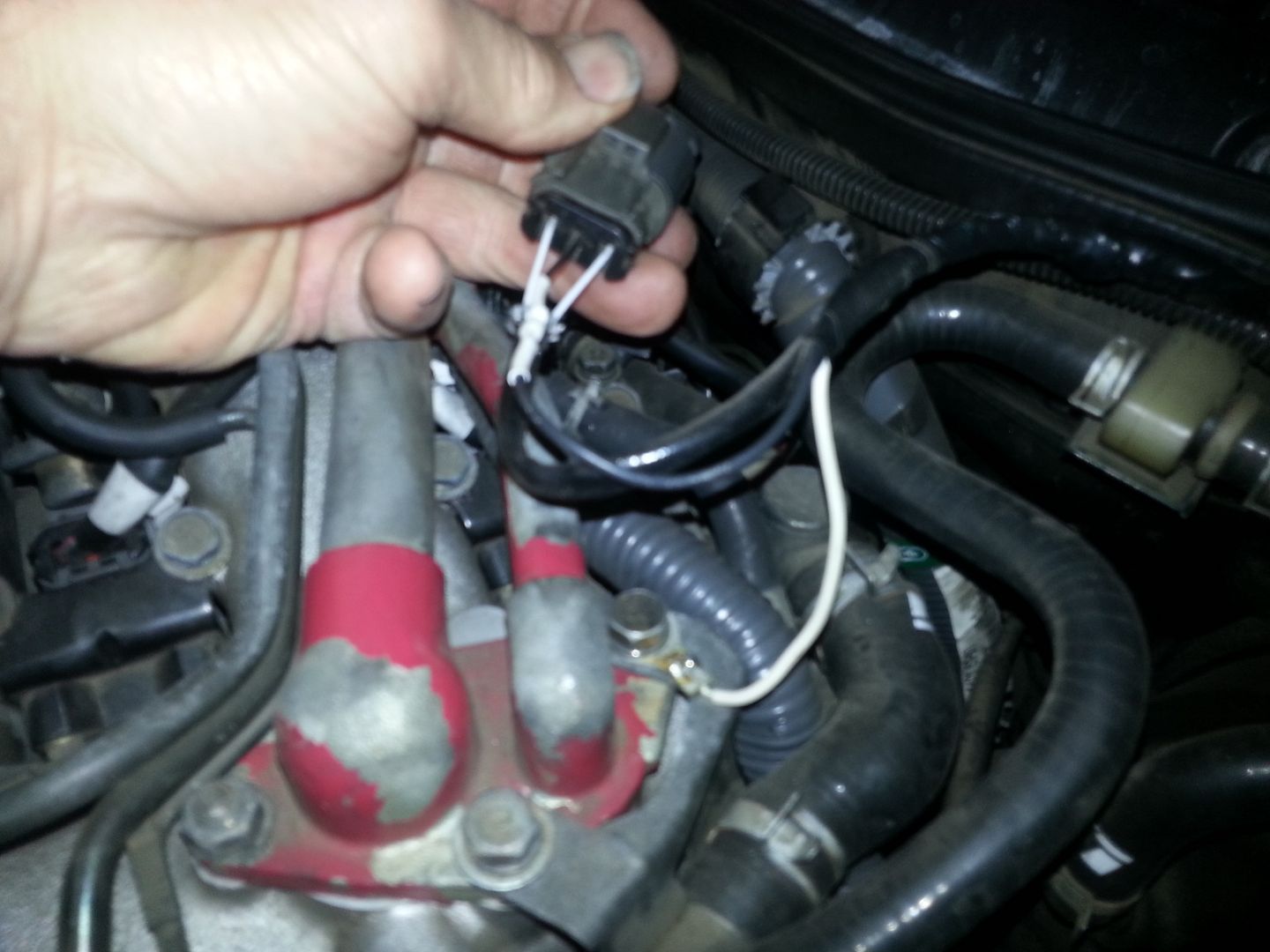

I installed TWO LC-1's last week, in my NA in about 2 hours.. I used the Plugs from the Org Narrowbands... this is not a permanent install, but readable and used for Logging..
I Wired the Power from the Plug ( one Outside) and got an Un-Switched ground at the Crossover Tube( white wire with Lug on the End ).. The O2 Sig ( Narrowband ) went in the Center of the Plug from the LC-1's Out 1 Sig..
I coiled the LC-1 up next to the front of the Engine Bay..

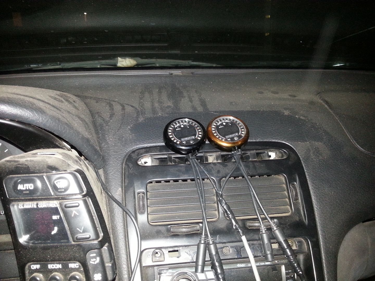

and the XD-16 gauges ( really like them ) are zip tied to the Center of the Dash.. ( Dirt Optional )..
Drivers side shown.. Passenger side Similar.. The WB Sensors are screwed into the Org NB Bungs in the exhaust, and are feeding a NB Sig to the ECU.. The WB Sig is coming out Digital to the XD-16 Gauges..
Likely after the testing/Logging is done, I'll go back to the Factory NB Sensors..
